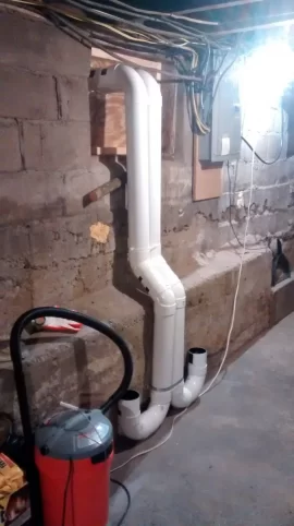

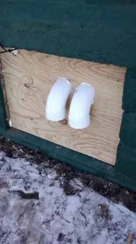

Here is my air intake setup. Opening a window would suffice in the basement; however, my setup only draws air in as needed with the "J" setup on the bottom. As far as having a drafty house goes, I too believed this at one point. I was having a terrific problem with liquid creosote and I contacted the manufacturer. The very first question they asked me what if I had fresh air coming in. I said yeah, I have lots of drafty windows and doors. They said to install a fresh air vent, and pretty much not to call back until I did. So, I did. And they were right. It pretty much got rid of all of my creosote.
So much more efficient if it is hooked up directly to the stove... where it is drawn as needed by combustion blower.
So much more efficient if it is hooked up directly to the stove... where is is drawn as needed by combustion blower.
I have a Yukon Polar oil/wood/coal combination furnace. It does not have a combustion blower, and does not have a connection to the furnace. I realize I don't have the same setup as the OP, but the concept is the same.
Reactions: Lake Girl
I have a Yukon Husky and a similar OAK...I don't think the furnace itself would need it but the barometric damper on the chimney does! Tons of air flow there
