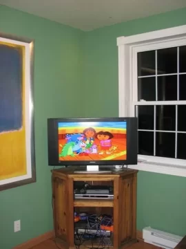

I am about to build my hearth and have a few last questions to ask all you knowledgeable folks before it is too late.
The stove being installed is a VC resolute acclaim with back and bottom heat shields and double wall piping - it is a corner install.
1) The stove is going to be placed Near a window - due to the layout of the room and placement of the all-important TV. Is this a problem and are there any special considerations that need to be taken in?
The dealer said that as long as the stove has 15 inches back clearance from the outermost point of the wall it should be fine. I am taking the outermost point to be the baseboard heater.
Nothing sticks out further than that.
2) I am planning to build a subfloor of 1/2 inch PLywood fastened with deck screws directly to the floating floor, 1 layer of Durock fastened with Durock screws, mortar and Slate tile.
3) The resolute door is just shy of 22 inches - code here is for 18 inches of floor protection in front of the stove - although the dealer recommended to go 22 for extra protection and even more if I have room for it.
Install date is 1 1/2 weeks away - so I have time enough - just want to make sure my plans are in good order first.
Problems? Comments? Suggestions?

The baseboard heater is all metal right? I don't think you have to include that in your clearances, plus it is low to the ground and not going to get much heat there.
Also, floating floors.... float. Do you really want to run deck screws through it? Best bet might be to take plywood and put durock and tile on that. Then trim out the edges, and drop it in place. A portable hearth pad. With the weight its not going to go anywhere.

I'm guessing from the picture that you will be putting the stove where the TV is now? If so, the window moulding is probably the thing you will want to watch for clearance measurements. You may loose some heat out the window, as well, but I'm not sure how big an issue that will be.
Assuming the stove just says "non-combustible floor" for the hearth spec, your plan sounds reasonable, though I'd put a layer of thinset under the Durock (between it and the plywood) as well using it to anchor the slates. Note that if you look at the Durock document on hearth construction they advise using latex fortified thinset mortar - I used "Flexbond" on my extension and it seems to have worked pretty well.

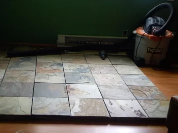

HI,
I have built my hearth which is 6*6 feet and consists of a layer of plywood(1/2 inch) thinset, durock, and slate tiles - all I have left to do is grout and the installers will be here this week.
Here are some early photos.
Thanks to everyone for the input thus far.
Nick

Looks good so far.
