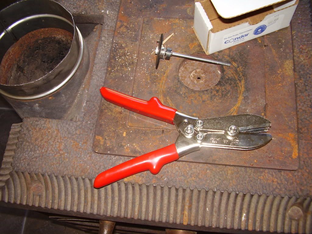

Sometimes you have to cut a piece. There are a number of ways to do this. I've used tin snips (be careful of sharp edges), a hack saw, sawzall (which yanks the pipe back and forth rapidly) and my favorite is the angle grinder with a cutting wheel on it. Use a piece of tape to give a nice sharp line to follow. If you have to crimp an end smaller, you can pick up a pair of crimps at a plumbing store.
[Hearth.com] Finally did it,  bought a Englander 30-NC
Just slowly work your way around the pipe squeezing and shrinking the metal.
