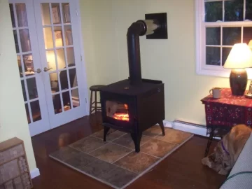

Here's the stove:

yep in the morning when you rake your coals. I try to get all the good coals to one side shovel the other side. Then i move the coals to the side i just shoveled and shovel out the last side. rake the coals to the front in front of the air inlet toss in more wood and let her rip.
Nice looking stove!The house should be toasty warm this winter without a large monthly energy bill. :coolsmile:
It does look nice in that setting. Do the french doors still operate and clear the hearth? I was wondering if the house would heat more evenly with them open.
Unfortunately, the french doors don't quite clear the hearth. I had originally planned to swap the doors so they open out to the other room, but they're pre-hung and I don't think there's any chance I could get them to hang right, so, once it gets to be winter, we'll take the doors off for the heating season.
The spot we put the stove in is not the ideal place, but it was the best place - really the only place - to locate the chimney. Ultimately, with the doors removed, it is an excellent place for a heater, but still not the best place for the hearth.
I'm going to get a heat shield for the stove pipe. The clearance is right, but that all gets awfully hot. I can hold my hand there, but I just think I'll be more comfortable with the heat shield.
Nice stove and a nice hearth. Enjoy!
Nice install.
The heat shield will help a lot. I have one on my set up and was happy with the heat reduction on the wall behind the stove.

I just finished my install of a Napoleon 1400PL last week. I have had two overnight fires and have been very VERY impressed when I wake up in the morning and my 100 year old poorly insulted house house is 72 degrees on the first floor and 68 on the second. My question is...how far are you from the back wall. The manual says 12" i am at 11" on mine. I think I need a stove board back there. >:(
The stovepipe is 18", the stove itself is a bit beyond 12". Behind the stove it's really not that hot, due to the heat sheild. It's above the stove that has me bugged. I'm sure it's fine, but I'll sleep better with the heat shield.
I agree, the top is really hot. :bug: Now by a heat sheild do you mean above the stove. I have a thinbal just like yours but its only 18" above the stove. Is that a problem? I may have to post that question to the gang.
Tgun, is there a ceiling only 18" above the stove? If yes, that is a problem.
No No, I have 12" + ceilings,I have plenty of room. I was just wondering if the thimbal would get to hot being so close to the top of the stove.
12" ceilings are even worse, how did you get the stove in there :)? J/K. Sounds like you are fine.
That looks great, but do you have to cross over the hearth to ue those doors, or is there another entrance to that room? Sounds like this stove will work nicely for your house! Enjoy!
