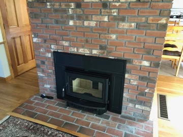

A nice installation job and now I'm starting my break-in fires.

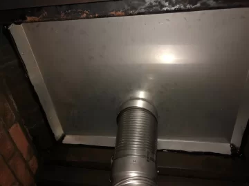

Here's the block-off. See-through fireplaces have their issues, but it comes in handy for monitoring stack temps.

I have been bad-mouthing two-sided see-through fireplaces, but after some weeks of having the Jotul insert burning, I have to say two things:
The back of the stove is not that ugly and is barely visible anyway if I close the glass doors on the dining room side of the fireplace, and...
With the glass doors open, I get a fair amount of heat off the back of the stove, which helps it find its way to other parts of the house.
It used to be a useless, inefficient, smoky mess as an open fireplace. But that's history.
-dan
