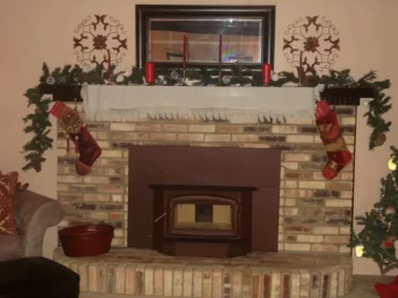

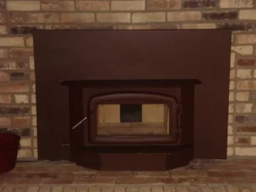

Just got Regency R14 installed tonight. Waiting for inspection on Wed.....Burn pics to follow!!! Color is Bark Brown from stove bright.

Congrats...looks great.
Clean looking install. One area to watch is the hearth protection in front of the stove. There should be 16" in front of the glass required in the manual.
Thx Begreen, I was able to squeak out 16 1/2 inches of hearth depth, glad that I did not have to do anything to the hearth to ext it.
