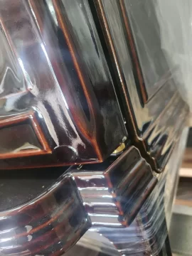

Here are some photos of the chip. I think it's just one, but the photos also look like they're taken from different sides, so I've sent a message asking. It comes with touch-up paint. Is this pretty standard on these stoves and I should expect a little chip here or there? Or would I be better off paying the extra $142 and doing the 2 hour drive to get a completely unchipped stove from the guy closer to home? What would you do?
I could of course ask if he's willing to discount the price for the chip, though I have no idea what would be fair.

I'm going to hold off on the stove with the chip. Unless the dealer is willing to discount to make up for it.
