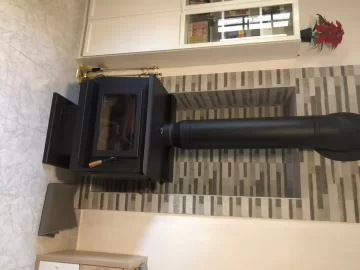

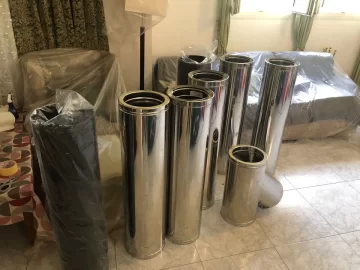

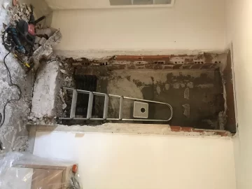

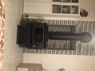

I definitely decided on a BK King KE 40
European Burner
Dec 17, 2021
27
Madrid
It's been a long time since I wrote in the forum, but in other posts I already mentioned that I had a Bodart/Gonay infire insert (there are videos on youtube) that I bought two years ago to heat my well-insulated 2-story house (1,900 ft2) located in the living room on the ground floor. I decided to do this because previously I used to heat the house with a diesel boiler and water radiators, but at the price of fuel today, this was no longer an option. Last year I convinced my mother to also heat her house with firewood and thus save considerably on the monthly bill. For her, I bought a Pacific energy Alderlea T4 stove from a Spanish distributor and when I saw the difference in performance compared to my insert, I began to think about changing my insert for a good stove. To do this I resorted to this forum that I already knew and I must admit that you are partly to blame for making this decision, because of what is manufactured in Europe there was nothing that convinced me. My insert worked well but I had to maintain very strong fires so that the fans would not turn off and thus be able to maintain 66.2º on the coldest days, a bit low temperature for my liking. In addition, this used up too much wood very quickly compared to the PE T4 stove and had to be recharged every 2 hours at most.
So I began to read and investigate this forum and I realized that there were many options but I wanted it to be a catalytic stove. The PE T6 would have been a good option for my house (the T4 is a true wonder how it works) but I insist that I wanted to test the long combustion times and I had already decided that it had to be catalytic. With this clear and after reading many opinions in this forum, I was left with 3 possible options that caught my attention, Blaze King (KE 40 Ultra), Regency (F5200) and Woodstock (Ideal steel or Progress Hybrid). My first choice was BK and not only because of the long burning times, but also because of the very good comments on its thermostat, but I had to have other options in case I had a problem buying it. In Europe there are no stoves or catalytic inserts that I know of and I know practically all the brands, so I looked for possible BK distributors in Europe (I live in Spain). I found a distributor for Europe in the Czech Republic and a company in Italy that also advertised that they sold BK. When I contacted them, neither of them had stock for several years, so my options were reduced to buying in the USA or Canada. This meant that he had to import, pay duties, go through customs and assume the cost of air transportation for a stove weighing 400 pounds. Even so, I began to write to all the stores that appeared on the internet as BK distributors both in the USA and in Canada, focusing especially on those that were closer to international airports. I started to receive some offers but the minimum delivery time was 4 months. But it turns out that a retail store in Canada had an Ultra model that I wanted in stock and they offered to sell it to me while others didn't want to sell outside of their country. They were charming and treated me in an exquisite way, which has helped me a lot to be able to buy the stove since for me everything was a sea of doubts. They made me an offer for the stove and I asked them to include a combustor, door and glass gaskets with their cement, a thermostat and several spare bricks. Here began the first part of the adventure because when making the payment I had the problem that when exchanging currency the commission was very high, I thought of doing it with Transferwise but at that time they did not allow opening more accounts so I had to talk to my bank and register on an internal platform so that the currency exchange would be more reasonable. In this the bank took almost 2 weeks and once I did it I could already manage the collection. I contacted several agents and the most favorable in this case was UPS by air option. The problem for my supplier is that he had to register to obtain a CERS document in order to be able to export the stove and this had to take more than two weeks until they got it. The stove was definitely picked up and shipped to my house. Now the second part of the adventure begins, since everything I had planned to do the installation could not be done. Reading on various podscats here that the BK 40s were very sensitive to chimney installation, I began to suspect that I couldn't do an installation to my discretion. I contacted BKVP to ask for advice and with very good judgment they advised me and convinced me that the installation was essential to be done in double-walled insulated pipe from the outlet of the stove to the last meter of pipe.
This, in addition to making the installation more expensive, forced me to put a pipe with an outside diameter of 9.84 inches and made me doubt that I would not have problems when inserting the pipe through the masonry chimney. To be able to introduce the stove in the living room we had to dismantle the frames of a door (I don't understand why in Europe they make the doors so narrow). Once placed in the final place, it has been installed respecting the lengths recommended in the installation manual and inevitably putting 2 elbows of 45º to be able to direct the pipe inside the masonry chimney.
It has been a great bet with a very high total cost and I am looking forward to testing it and verifying such good comments that I have read and heard about this device. I promise to do a review when the time comes and to be able to share it with you.

Now that it's all set up that stove should do wonders for you! Especially as a primary heat source. I love the tile work done behind, looks beautiful and warm☺️
Poindexter
Jun 28, 2014
3,125
Fairbanks, Alaska
I too love your brickwork behind the stove. I am not sure how my wife would feel about, but I think it is awesome.
You have experienced Canadian friendliness firsthand now. I think there are only about 2 dozen rude people with Canadian citizenship. The high school guidance counselors direct them into customs and border control, once you are across the border everyone else inside the border is nice.
I would encourage you to get your break-in burns done as described in the manual while your weather is still warm. I have a different stove, but the first break-in burn was noticeably stinky, the second not so much. The third break in burn I could not smell at all, but my wife said she smelled the third one too. Getting those out of the way with windows open is a good idea.
Good luck and best wishes.

Congrats on getting a fantastic stove! I agree with Poindexter that the tiles look great.
Do you have dry wood (preferably moisture content < 20%, but in a bind up to 25%) ready?
These stoves do not do well when fed wood that's not to their liking.
(The good thing is that central Spain is rather dry, allowing for fast drying of firewood once it's split. I've been in Madrid a couple of times. Once when it was 40 C = 104 F, and it is not at all suffering like 100 F in 90-100% humidity in East TN is...)

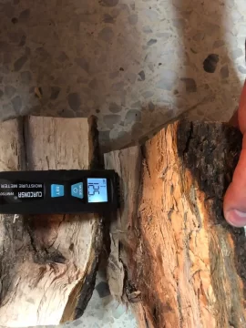

Thanks for the answers. So we all agree that we like how mosaics look except my wife who says I was wrong to choose them and it looks like a bathroom. That happens to me for getting into things in the houses where they rule. I've told her that she looks very nice but I don't finish convincing her.
As for wood moisture and after reading so much here, I bought a meter on Amazon and since last year I've been making sure the wood is really dry. Here we use oak, holm oak or olive as hardwood and I normally get it between 7% and 15% humidity. I am aware that catalytic stoves are sensitive to this.

7-15%? wow.
Did you measure that on a surface of a split that you just exposed before measuring by resplitting the wood?
I'm not saying it's impossible in Madrid, but it's the best I every heard, if measured on the inside of the wood rather than the outside that has already dried out.
If you're burning 7% oak (which likely will be white oak for the Americans here), you're the luckiest burner on this forum!

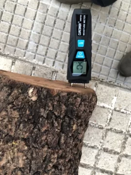

I enclose photographs of the same trunk measured on the outside and then split and measured on the inside. This is the average humidity that I have in my firewood.

That outside measurent does not mean anything (because it's outside, and because it's not oriented right - these things are calibrated and you need to take the anisotropy of the electrical properties of the wood into account, so pins on the cut surface don't make sense).
The inside one is fantastic. Bit close to the cut end (best is in the middle of the split), but that's not going to change the "fantastic" conclusion here. Lucky you.

@European Burner ,
As @stoveliker has already pointed out, pushing your two pins into the endgrain of a piece of wood is not helpful. The circuitry and technology is simply not set up to make an accurate measurement that way.
What you want to do with those two pins is cross the fewest number of growth rings as possible, and you need to be inside the piece of wood fuel that you think is seasoned, more like your second picture.
Getting into the finer points of thing, imagine your otherwise triangular cross section split logs measures 10x10 cm. Split one of those in half, so you have two pieces about 5x10 cm and whatever length, perhaps 50 cm long.
Next identify the freshly exposed face of one of the two pieces you just made. You want your two pins pushed _deeply_ into the freshly exposed face in the fatter part of the wood, and not in a grey/dry branch adjacent to still orange trunk wood. And more or less parallel to the grain lines.
In fast growing wood like for instance Douglas Fir common in western North America I can often get both pins in the same band of light wood without crossing any growth rings. In slower growing wood, like maybe an eastern North American Oak growing in a dense forest with the growth rings very close together, the best anyone can do is see the grain and come as close as you can to not crossing any growth rings. There is your accurate moisture measurement.
Modern catalytic stoves are _extremely_ sensitive to damp fuel. You can get away with 22% moisture content when measuring as I have just described. 20% should be your target, and the folks who can get there usually like 18% even better. I really like to get my fuel dried to 14-15%, but I burn a LOT of it; and I don't have a reputation around here for doing things by halves.
I spent a couple weeks in Andalucía in the late 1990s. 400 year old olive trees have about the same trunk diameter as 25 year old Douglas Fir if my guide was being honest about the olive trees. Olive wood is probably fairly hard to get dry, but you got those blistering Iberian summers working for you.
You got a lot of money invested already, and a beautiful install. I encourage you to crack open a few splits, maybe half dozen of them, and measure the actual moisture content of the orange wood parallel to the grain on the freshly exposed face, towards the middle of the length of each split, in the wide part. The ends of all your splits, and the splits at the top of your stacks are very likely to be drier, have a lower moisture content, than the splits you stacked the same day at the bottom of each stack.
I don't remember exactly when the fair happened in Cordoba, but your drying season isn't over yet. If you have good airflow on your stacks you have weeks and weeks for your wood fuel to get drier before you start burning it.

Very interesting answers. Despite the fact that I have read a lot about how important humidity is in wood for catalytic stoves, all this is new to me and I try to do the right thing as best I can, even if it is not easy. I don't have a forest to be able to cut trees, although my goal in the future is to get free firewood. The firewood that I have stored is the oak from Spain. It is one of the hardest woods that exist here (attached photo), and you get some incredible coals in addition to giving a great amount of heat and the reason for not inserting more the pins of my humidity meter is that in no part of the log I am able to do it without it breaking. However, I will consider that the firewood may not be as dry as you might initially think, although the sellers assure that it is dry. Also and for the moment I have thought about buying more firewood and storing it for at least one more year before burning it. It is true that the summers here are scorching and that helps. Until I turn on the stove I don't really know how it will work and if my firewood will be up to it, I hope I won't have any problems.
Thank you very much for your comments because they are very helpful.
