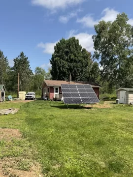

Well the array is in and online, total out of pocket cost after state and federal credits is $10,500 for a small 3.6KWh 8 panel array. Unfortunately the power utility won’t do credits so it’s month to month and they pay just a penny per KWh if I don’t use the unused power put back into the grid . I’m making 50% more power than I use now and next year I’ll buy a new Bolt 2 EV if they introduce it then or possibly I’ll get a used one, time will tell. If I need to buy some power that’s fine since it’s not too expensive at $0.123 per KWh any time of the day or night.
PS: the panels are Longo 450W, the microinverters are Enphase IQ7A’s, the combiner is a Enphase. It’s a ground mount array. [Hearth.com] Finally pulled the trigger on solar
