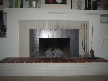

What are the dimensions of the current fireplace and hearth? If you can post a picture of the current hearth that would be great.

Here's a pic. The carpet will be wood. The raised hearth will be lowered, flush with the floor, tiled and extended (that raised hearth sits on top of 6 inches of concrete in the floor joists). The wood trim will extend down, and the brick will be covered in tile. The actual fireplace opening is the same size as that piece of steel, which was a temporary fix to get an open fire to draw (otherwise ratio of opening to flue was too big). Revised opening will be 48 inches wide and 35.5 inches tall. Wood trim is 12 inches from the edge of the opening all around. Current firebox is 20 inches deep at the center.
Anyway, so the Castine (or 3CB, or Black Bear, or any other suggestion) will sit at floor level, rear vent back 20 inches, and then straight up.

That helps, what's the metallic stuff surrounding the firebox opening? The reason I'm asking is to see if you really need to remove the hearth, or not. If that is just metal trim, then can it be removed to enlarge the opening and allow the current hearth to remain at its current height?

That metal is a temporary steel plate I used to shrink the firebox opening--without it, an open fire won't draw well enough, since the former owners changed the flue from 12x12 to 8x12 (for an old, terrible, terrifying insert that we took to the dump).
The REAL opening is basically the size of the steel's OUTER edge, which is 24.5" tall and 48" wide. So this firebox is fairly small, even without the steel. In a rear-vent setup, the top of the pipe on a castine is 29.5" off the floor--I've measured it all out, and the only other option would be an F100 Nordic, fully INSIDE the firebox, with the short leg kit, top-vented. With an exterior chimney, I just don't want to lose all the heat to the outside.
If I lower the hearth, the opening will be 35" tall and 48" wide.

Riverstone, can you look up your chimney flue and see if it is a clear straight shot or if it's offset or if it has misaligned tiles? Have you been on the roof to see how this 8x12 tile retrofit was done? It would help to see this too (take the camera and snap a shot) and to know the ID of the current tile pipe. In a way it's too bad they did this. With a 12x12 tile it would have been easy to drop an insulated pipe down to the stove. I suppose it could be busted out somehow. Jim's suggestion is a good one if the fit is snug.
The wood trim may be a small issue that needs to be worked around. The stove will need it's minimum clearances to combustibles followed. It can be protected with a sheetmetal guard that is offset to allow an airspace behind it. This can be painted with high-temp white paint and removed in the summer for a cleaner look when the stove in not in use.

Can you direct me a bit more on the mantle clearance? The Jotul manuals reference a clearance from the top of stove to trim and mantle, but I assume that's if the stove is directly below a combustible surface. What if it's out in front of the firebox a bit--i.e. the back of the stove is in FRONT of the plane that the mantle/trim is on? I'll use double wall pipe to the liner T, so pipe clearance shouldn't be an issue.
If there's still a clearance issue from the top of the stove to the mantle, I may be back to putting the whole thing INSIDE of the firebox.
If the double-wall stove pipe is what is directly below the wood trim then I would expect the pipe clearance requirements to be the guideline.

I'm not following this line of thought. The opening is about 35" high, and 20" deep. Is that correct? The Castine is about 29" high and 23" deep, including the ash lip.
Some how I don't think this is going to be an issue. Even if a heat shield for the mantel would be required, it would be a relatively shallow one for the little projection of the stove. It could be attached to the metal lintel support and be painted high-temp white. Perhaps this is a issue of perception rather than a real problem?

In fact the Castine would fit ENTIRELY inside the firebox, which is 28" wide at the back, 27" deep, and (will be) 35" tall. If I were to do that, as I've asked about in another thread, I guess the masonry firebox would act as a heat shield and I wouldn't need to worry about clearance. I don't want to beat a dead horse, as I know it's been discussed around here a fair amount, but I had been convinced that putting the stove so deep into the firebox, which is exterior, would mean I'd lose most of the heat gain of the bigger stove to the outside world. But now that I think about it again, maybe it's just better to have the bigger stove, which I prefer, and accept the fact that my exterior chimney is imperfect and will sink some heat?
Two other benefits would be that a stove fully in the firebox could be more or less TOP vented, especially with flex, rather than rear, and the larger stove could be moved to a bigger house down the line.
**If it were you, would you go for a smaller stove out in the room somewhat, or a larger stove fully in the exterior firebox? Seems most of my respondents prefer the larger stove...
