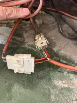

Hi all, I recently picked up a used biomass 60. I can’t seem to get the combustion fan to run. When u turn the unit on the draft fan will run but the front fan never kicks on. Here is a picture of the wire harness. There’s no juice going to the wires to the front fan. In the pic the wires going to the right go to the front fan, the left go to the back fan. Do they look right?
