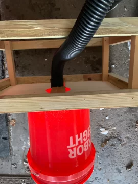

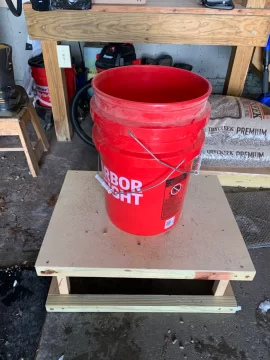

I made this fines vacuum that I want to share.

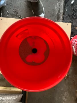

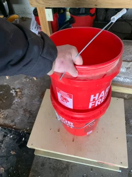

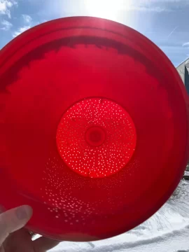

First I built a small platform about 8-10 inches tall. I mounted a 5 gallon bucket to it. The bucket has a hole in the bottom of it along with the platform to insert a vacuum nozzle. I took the 2nd bucket and perforated the bottom with a bunch of small holes. I pour a half a bag in the 2nd bucket and let the vacuum do its work. when I stick my hand in there, I can feel the air move thru the pellets. I pull out the bucket and dump them in my transfer bucket, Then I pit them back in the vacuum bucket. I do this about 3 or 4 times. Then I repeat the process for the other half of the bag. Does it work? I'll see when I rip the vacuum bag open.Cuts the dust down. Please comment And let me know if I waster 2 buckets. Thanks , Matt.

My stove burns the fines. If your stove does not and blocks hopper or auger then you are not wasting buckets or time. A clean stove is the best maintenance .

nice setup but myself i cant see me moving or picking up 40lb bags more than to stack or pour into stove..

For me it's good, as my hopper only holds 60 pounds, and I have steps going down to the basement. I can fill my buckets, put them in my porch, then carry one down when I need it. I have one full bag in the furnace room just in case. If somehow I had a bigger garage with taller door oit would be great as the guy could fork lift them right in. As it is I use a wheelbarrow with 4 bags on it to get them in.

Some stoves to not pull the fines into the purn chamber and ends up plugging up the feed over time and loosing performance on the stove. I have to empty my hopper every few months and vacuumed out the fines

Maybe you should start screening them first. That might be less work than sending them through your stove. That will only help the fines though, if they are loaded full of minerals it won't help that part. My pellets are really good, but I still get hard deposits on my burn pot. I almost need a chisel and hammer to break them off. I have two scrapers, a pointed one and a flat one so I manage.
