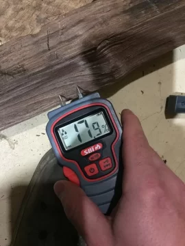

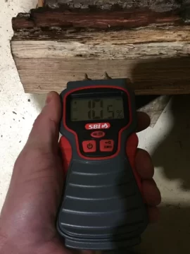

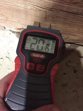

The majority of it does not hiss or sizzle. Just for kicks, I just went downstairs and split three separate pieces and stuck the MC meter in them. The results certainly don't support my argument (but still not bad IMO).;lol
[Hearth.com] Finicky stove or finicky user? [Hearth.com] Finicky stove or finicky user? [Hearth.com] Finicky stove or finicky user?
Those were all just split down 5 minutes ago by me. They have been stored in the basement for about a week while they await their final destination.

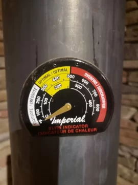

I have this on my single wall pipe. I usually let it climb to 500 or 600 than shut it down. Usually settles in at 4 or 450 I'd say what your doing is all good. When I moved into my house this stove was already here but no thermometer on it. I'm certain I burnt it way to hot on several occasions. [Hearth.com] Finicky stove or finicky user?
500º surface temp is ~900-1000º internal temp on single wall. That is pretty hot. Try starting to close down the air sooner, like around 250 to 300º.

I have this on my single wall pipe. I usually let it climb to 500 or 600 than shut it down. Usually settles in at 4 or 450 I'd say what your doing is all good. When I moved into my house this stove was already here but no thermometer on it. I'm certain I burnt it way to hot on several occasions. View attachment 242023
I have that exact magnetic thermometer on my flue (in addition to the Auber AT210). FYI it’s been prett accurate to my digital thermometer readings, minus the obvious delay for the spring to catch up.
