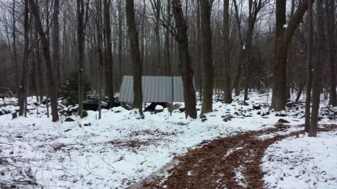

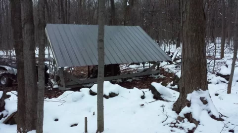

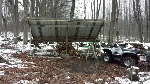

I have been itching to build a woodshed ever since I found this site. I had dreams of a masterfully built shed..however, with 2 kids under too and on one income, I wanted to do it as big as possible and cheap as possible.
I started with 3 skids that this years pellets were delivered on. Cost $0.
I found some old cement blocks around the property. Flattend the area, but did not level the ground. This is on a slope, and I made the structure level, but not to itself. Cost $0
My friend told me he was getting a new deck and was kind enough to drive the big scraps to my house. Cost $0 (well it did cost me a beer)
I laid out the free lumber and found the best pcs. It ended up being about 15' long and 8' deep.
I ordered 10' x 3' sections of metal roofing from Home Depot. Cost $179
Needed extra 2x4x8's and 2x4x10's for metal roofing support. $80
Special star pattern deck screws that can be installed with my impact (best investment ever) $20
This is literally the first structure I have every build myself (no plans and almost no idea what I'm doing) and my intention was to do it on the cheap..purely functional, not pretty, but blend into the landscape as best as possible. So be gentle.
