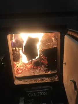

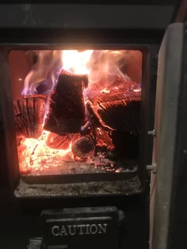

This will last me all night. I started cold because I got off a 36 hour EMS shift. A layer of three and four inch ash then add large oak splits and let them get burning one at a time while the inducer is running. If you try to add too fast it will never get a good burn, just get hot and burn up the wood in no time. I have the slidernonly open about 1/4 inch as I do this. once everything is charred and burning a blue flame I open the slider to 3/8 and let it do its thing. I hope this helps.
The stove has a draft adjustment? Being a newbie, guess I am not following what the slider is. Can you show a pic or explain?

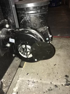

The outdoor units do have a manual draft adjustment. The indoor units do not. I’m not sure why they don’t but it may be related to the shorter length of the stack on the outdoor models.

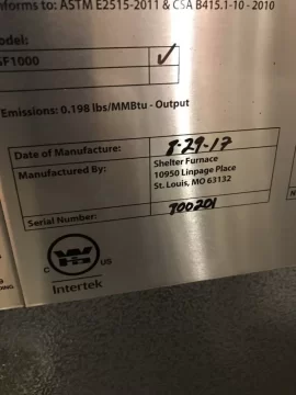

Thanks for the photos! Wonder what S/N mine will be.
