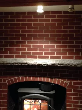

I realize that fire codes differ from state to state, but is it against fire code in genera to put a vent that would allow hot air from the fire place to go up to the second floor? It would be up against the chimney (see picture). We have an interior chimney. We would love to put a vent in the ceiling and then have that open into the hallway wall above so that we get more heat upstairs (right now, the propane has to heat the upstairs, the downstairs is fine with the wood stove heat).
it would not break into the chimney or flue in anyway just something to let the hot air get upstairs.
I hope this makes sense.

A couple things come to mind. One is that a return duct can not be within 10 ft of a stove. And the other is a requirement for a fusible link damper to be in any through the floor penetration. Both seem like they can be honored by offsetting the opening to achieve 10 ft. and adding a fusible link damper collar between the ceiling grille and the upstairs floor register is pretty easy. Atlanta Supply has the parts you need.
