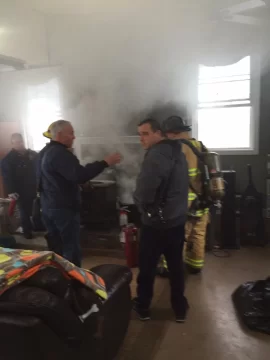

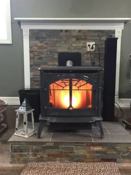

Here are some pictures of how the stove was installed which I though looked great and the event after. The new owner was cleaning it twice a week and was just cleaned when they came home to a hopper fire.
Has anyone ever heard of a clogged exhaust port causing this? I would have thought it would have just went out!

I thought they did a great job with the install as well and they had been burning for months now. I sold it to them in early November. This occurred this past week. I was very sorry to hear this happened and am concerned for the two stoves I burn now and for their terrible loss. I have no more info on the stove other than that last ugly pic of the fire. :(
