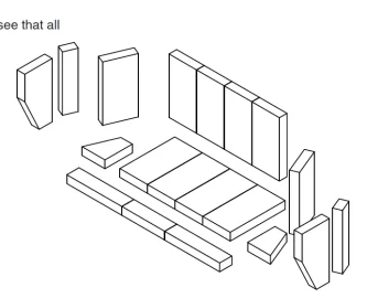

Go to the website for the companies and download the stove manuals. Look at the firebrick layout. A standard firebrick is 4.5 x 9". The layout should indicate firebox size. Of the two stoves mentioned the Jotul is an E/W loader and the Enviro has a squarish firebox for N/S or E/W loading.

Unfortunately I can't find firebox internal dimensions for Regency CI2600/HI400 in there manual. I would like to compare there sizes with Boston and Cabello from Enviro to find out if I can load N/S.
Firebrick pattern says it all. This is an E/W loader.
