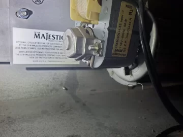

Fire place is gas magnifice, see the pic for details.

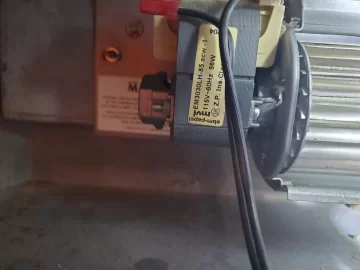

I don't know how if the motor is bushing or bearings. I attached a picture of it below

For what that blower costs I would just replace it.
Reactions: sxsrivas
Some you have to dissassemble and get it from inside the firebox. Some you can easily get it out from the service access where the valve is. Wish I could give you a more helpful answer but only you can tell if its within your ability.
