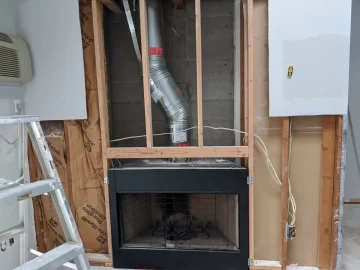

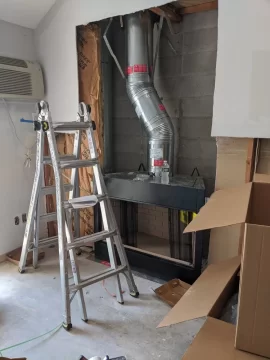

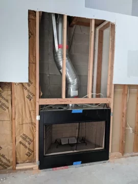

Hi, all:
What might be causing chimney (metal flue) banging sounds during wind gusts? July 2020 professional install of a pre-fab wood burning fireplace (flue construction pictures are below). We had a very windy day here, and with every strong gust the chimney would make a banging sound like this (fireplace was not in use at the time - damper was closed):

In retrospect, this was going on for some time, but I was never really able to pin-point the source until now and banging was much more muffled before. Appreciate any info. TIA!!

Is the roof accessible? If so, on a calm day go up and try to move the chimney back and forth. It looks like it is hanging in a sling made up from the straps which may be allowing movement in the offset. If that is the case I think adding a rigid brace inside of the chase may be warranted.

Thank you! The roof is not accessible to me (high slope and I don't have ladder tall enough to get up there). The original installer will be here in 2 weeks. I'm concerned about the safety. The straps themselves are there for fail-safe - they do not have any tension on them. In the high wind gusts I can hear high pitch squeaking noise coming from the cap if I'm outside, but don't see any movement.
I am not comfortable with the weight of the system sitting on offset elbows. Many chimney pipe manufacturers require bracing to support the elbows. Do you know what brand chimney was installed or what is the make and model of the fireplace?
THANK YOU!! It's a heatilator element EL42 and was put in 8 months ago by an authorized installer. The installation manual is here: https://downloads.hearthnhome.com/installManuals/4044_188.pdf Can you offer some expertise feedback if the install was done correctly?

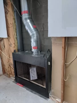

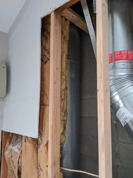

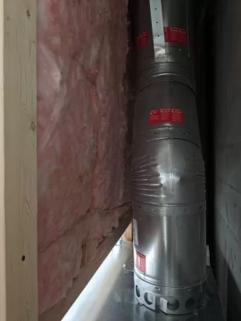

Here are some additional photos I have. All the drywall since has been closed up of course. I have an R13 insulation in there, so I'm sure the actual sound is far louder than what I could capture on the recordings. The installer came out yesterday and put up an iPhone on a selfie stick up the flue: says that there's no pipe separations, but did tell me that at the top they put in new piping through old flue, so the space between them is what's causing it. They are coming out in 2 weeks to go up on the roof, and if that's not the problem, then drywall has to come down to open up the chase. Many concerns here at this point :/

They strapped it, which is proper, but the banging in strong winds implies movement. Roughly how tall is the chimney? Is this a one or two story setup? I'm wondering if there is a firestop at the first floor level.
The total chimney length is about 14-15 ft. (from firebox top to the cap). I'm on the top (second) floor condo and it's going directly in the roof (I have vaulted ceiling, hence the total height). Thank you again! I'm just looking for an advice and right direction. Everything passed inspection (I did pull a permit for this).

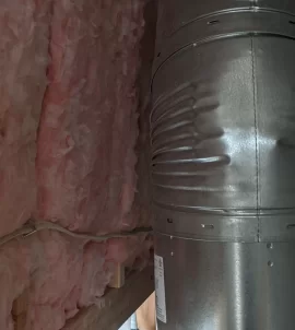

I am not sure but it looks like there are some clearance issues with that chimney

Thank you! I looked over the installation manual, and only chimney clearance referenced there are for the header and maintaining 2" air space around it. I believe all those are met. Is this what you're referring to? Thanks in advance!
The 2" is what I was referring to it doesn't look like it has 2" especially to the fiberglass
Oh, that's just the angle of the photo that makes it seem that way... sorry, it's the only ones I got, but here's a close up. There's 2" minimum clearance there and nothing is touching the flue. Put in the fiberglass/drywall myself, total overkill on the staples - i think I put them in every 4" or so.
Good that is why I said I wasn't sure

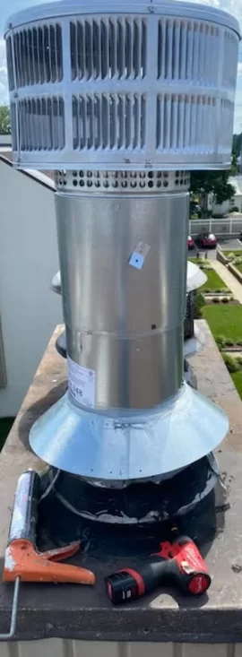

I don't know if you can get close enough, but a camera outside looking at the chimney top might also give insight
When the loud banging initially occurred in 3/28 winds, I did run outside - I can see chimney/cap from my balcony. There was no visible movement , just a high pitch squeaking sound. It did not show up as anything legible on the recording, so installer just had to take my word for it.
