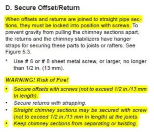

Opened up the drywall. The offset and return were not secured with screws. Offset is actually separating from the lower chimney section bead. Manufacturer spent 4 pages warning fire risk and even provided screws and drill holes for the elbow. I don't know what the installer's excuse was.

Oh, I'm still fuming... after pressing the issue of not using the screws to secure offset/return, vague replies, and *much run-around this is the final email I got from the guy who did the actual installation at 5:19EST. I've taken out the PID, but in all honesty I cannot understand how any legitimate business can operate this way and throw some poor schmuck under the bus while they're at it. Certainly MANY questions regarding firestop photo they've provided (attached). Saga is not over yet. Getting a 3rd party inspector after they're done for sure. I don't even know how to respond to this.......
Tatyana,
I fully understand your concerns and please understand that we take this situation very seriously, we aim for a happy customer and complete installation with safety in mind at every level!
Between ******** and myself installing this fireplace we missed this very important aspect of the installation and it is very important it gets resolved.
It was discovered that ******** had made several other mistakes when doing install projects and after resolving the ones we caught he was let go, but I was there too and trust me, I am very disappointed in myself for not identifying this before. I sincerely apologize for my lack of attentiveness.
As to your other point, the piece of pipe we left of your old fireplace was the chase flashing that covers the roof, and to remove that would require us to reflash all of the chimneys pipes terminating through your chase. That was never floated as an option as a practical solution. The cost and difficulty would have been staggering and would have affected your neighbor's flue too. Normal procedure is to use the existing hole and use the storm collar as a flashing to seal the gap.
That said, I have attached all of the pictures ******** took while on the roof and one from inside showing this sleeveing method, to what I at the time believed to be properly.
I recall explaining to ******** that he needed to secure the new pipe that was run through the old pipe with screws to center and anchor the new flue (like on a christmas tree stand) and strap it as well.
While he took no pictures of the anchoring process, you can see the strapping in images 3 & 5 near the bottom.
As I mentioned before, I feared that ******** hadn't screwed anchors to the pipe may be the cause of the banging and will reinforce that practice with ********.
These pictures should answer your remaining questions and if not, we will need to wait for ******** to take more pictures while he is there.
