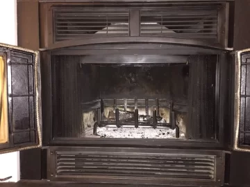

I have a prefab fireplace with a fan built in. Doors are cast iron (seen in the pictures). My dilemma is are these doors meant to be closed when a fire is going? I know in almost all cases they recommend doors should be open but that some prefabs have doors that can be closed. It seems like there is a fireproof seal/gasket on the inside of the door (seen in pic) which would lead me to believe these doors can be closed when a fire is going. I haven't located make/model of the fireplace yet, its been tough finding it, I'm going to look behind the lower louver tonight as a last ditch effort to find the tag. Any thoughts you all could give me on these doors that you can gather from the pictures would be great. I just want to get the most out of this prefab this year before I upgrade to something better and more efficient next year. Thanks,

Looks to me like they can be closed, but if the clear panels in the doors aren't PyroCeram or a similar
heat-resistant material, then I would burn the unit with the doors open.
If those panels are TEMPERED glass, they can EXPLODE if they get too hot.

I agree. I don't know if there is any clear cut way to test out if the doors can be closed or open other than to just do it and risk it or call out a professional and get their opinion in person. The glass feels and sounds (tapping and flicking of a fingernail) almost like a plastic/Plexiglas type of pane. Its not real high pitched when you tap something on it.

I am all but positive that is a zeroclearance stove the and doors are meant to be closed otherwise they would not have gaskets. Is there an air control anywhere on it? And i seriously doubt you are allowed to put any insert in that unit.

I don't believe there is any air control besides the built in fan that is just the flip of a light switch on the wall. There isn't any lever or knobs to open vents to regulate air flow or anything like that. Also aren't there inserts rated and made specifically for zero clearance units?

Some say they can be installed in zero clearance units but hardly any zeroclearance units allow inserts to be installed in them. In order to meet code and maintain the ul listings you need both manufacturer's blessing. Have you pulled the fan covers and anything eelse you can to look for a label?
can you post more detailed pics of the unit including the interior?

Ok I got some more pictures, let me know if you want anything specific. I couldn't find the make/model number, it seems like to remove the fan panel you have to unscrew a bunch of other stuff which I don't feel comfortable doing nor really have the time. What I did find by spotting a flashlight behind the bottom fan panel stuck on top was a sticker with a number, it seems to have a logo on it (maybe the brand of the fireplace?) let me know what you think, especially any more thoughts and opinions on if it's safe to shut these doors while the fire is burning.

ok now it looks more like a standard zeroclearance box. But those doors are not normal. did you look behind those screens for a tag that is where they usually are. I cant find a data base for warnock hersy numbers to tell what that unit is tested to
