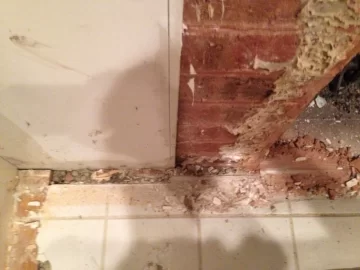

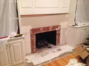

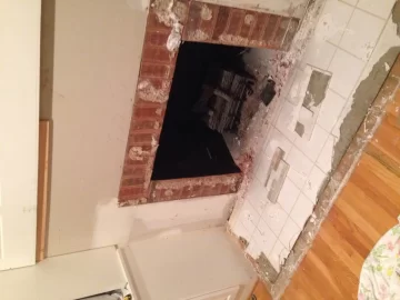

Here are some better pictures. Again, my concerns are mostly with respect to clearances to combustible material and weight distribution, but I appreciate all suggestions. Thanks!
[Hearth.com] Fireplace Facelift and TV Install[Hearth.com] Fireplace Facelift and TV Install [Hearth.com] Fireplace Facelift and TV Install
That helps. Looks like the black granite was glued to the brick. Not a good idea. Are you keeping the upper raised paneling? That is what I was referring to. Is this where the TV will be going? Maybe a simple sketch or two of your ideas
Actually, the black granite was glued to tile, which was glued to marble, which was glued to the brick.

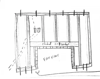

Here's a sketch of the proposed frame.
The plan is essentially the same, whether to float the whole frame and false wall 2" from the chimney wall and only have cement board and stone touching the fireplace brick, or to put the frame directly against the wall and stack a new layer of brick on the fireplace face so no framing is touching the fireplace brick (then putting stone on the new brick too).
Does that help? Thank you.
Yep, I'm with you now. Using Durock NexGen will provide some insulation between the fireplace masonry and the TV. If you go that route I would remove the drywall, route the wiring through the studs, then cover it all with Durock. That will give you a good substrate for the stone.
Or, consider attaching hat metal to the wall or framing with metal studs. That will create an airspace. It all depends on how much buildup you want in front of the current stud structure.
After the wall is re-covered I still would consider putting in a non-combustible mantel. At some point you may want to derive some real heat from the fireplace. In that case the solution will probably be a nice insert.
What about the weight of the false wall on the hearth extension and fastening the wall down? Any thoughts or concerns there?
Not really. If the Durock is fastened per directions at one screw every 8" with their screws, it will do fine. The sheer strength of these screws is quite high.
I have some doubts about whether it's a good idea to put wood framing around that fireplace opening (as your drawing seems to indicate), if you're planning on ever burning in it or adding a wood burning insert to it.
I would suggest using steel stud framing then there is no question or concern. Its fairly cheap at Lowes or HD and for the small area involved

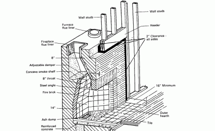

The idea would be to keep any thing that can burn away from the opening, maybe model it on this, no closer than the wood is to this fireplace opening, but check your codes.
