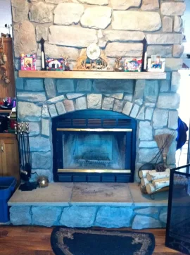

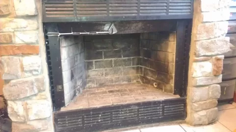

Hi all, I'm new to the whole fireplace situation and have a few (hundred) questions. We bought a foreclosed home a few years ago and have been slowly trying to make it better. It has a fireplace built in a corner of the kitchen/breakfast area. We have never attempted to use it and basically just let it stay in its corner out of the way collecting dust. This year, we are ready to get it fired up and try to alleviate some of the heating costs. I know little about fireplaces. I've looked it over and realize that it needs a good cleaning. I think a good chimney cleaning should probly be done. Other than that, I know nothing. I noticed a label inside that tells me it is a Temco insert, model TLC 363. When I tried to look for info online, it appeared to have glass doors originally. On the side of the fireplace, I also noticed a plug, I assume for a blower of some sort. My first set of questions are:
1) Do I need the doors to make this thing safely operational?
2) Do I need to get one of them fire log holder thingies?
3) What exactly does the plug do?
4) Would one of them CSL cleaning logs be sufficient for the chimney?
5) If I need doors, do they need to be specific to the fireplace, or can the be universal generic doors? Do they
make universal generic doors?
I've included a couple of pics and will provide more if needed. Thanks in advance to anyone that can coach me through this little fireplace for dummies session.

get a sweep out to clean it and inspect it also tell them the model number when you call they should be able to look up the manuals and tell you if it needs the doors or not at the least you need a screen and if the doors are required they need to be the doors from temco. I have no idea what that plug is for i have never seen anything like that definatly not by the book.
Model is a Temco TLC363. It's a very standard unit. Here is the manual: (broken link removed)
There should have been side curtains for spark screening with the unit. I don't think the blower if there is one, is stock. It looks jerry-rigged.
Be also aware that such a builder-grade fireplace insert will do little to reduce your heating cost. You will get some radiant heat sitting in front of it but at the same time it will suck a whole lot of heated room air out of the house and send it up the flue. Efficiencies for a standard fireplace are usually below 20% and can even go negative meaning you are losing more heat than you are gaining from burning the wood.

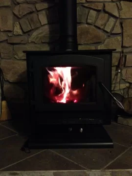

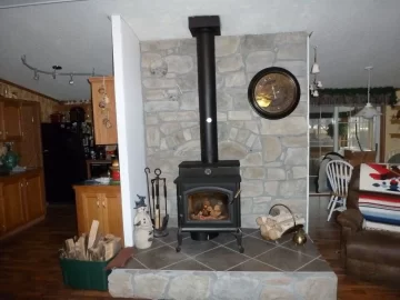

To a Quadrafire 3100 ACT

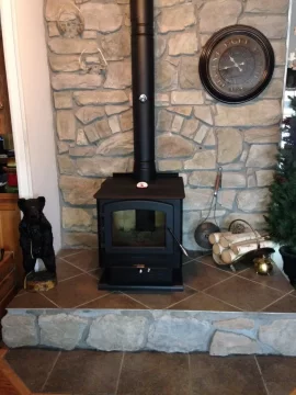

To Englander 30NC

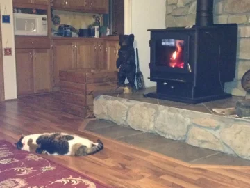

Cat is saying wheres my fire?
[Hearth.com] Fireplace ignorance [Hearth.com] Fireplace ignorance
Reactions: Grisu
You might as well start taking some measurements not to see what insert/stove you want to put in there.
That old fireplace is just a waste of perfectly good firewood.
Reactions: Seanm
You can not put a insert in the Temco, best thing to do is tear down and start from scratch.
Reactions: claydogg84
