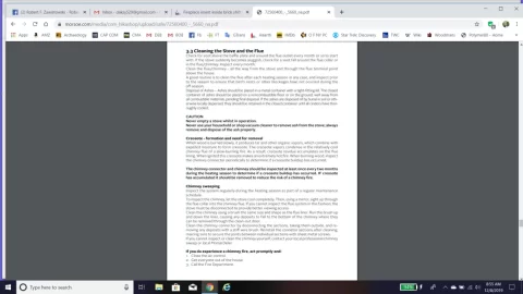

Someone with your unit will have to chime in on the fire brick situation,
but as far as maintenance goes you ALREADY have the answers.
From your manual...
