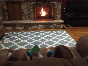

Newbie homeowner here and new to fireplaces in general. I'm looking into installing a wood fireplace insert into our den's fireplace. The den is rather large (almost 600 square feet) with 14 foot cathedral ceilings. The room is always cold and it's not something that can be fixed with my current HVAC setup. (I'm sure the 14 ceiling doesn't help).
A friend recommended that get a fireplace insert to heat the room. I've been doing my research online but I still don't quite get how it differs from a regular fireplace. I understand that they are more efficient. But do they light the same way? Do I have have to constantly tend to the fire while its burning? Is it as messy? I was told to expect to spend around $5000.00. Before I take the plunge, I need to know what I'm getting into.

Hi Newb. Inserts and stoves are vastly superior in their heat output and generally take less feeding and tending than an open fireplace. In an open fireplace you have virtually no control over the burn because you can't control the air. Fireplaces can actually result in a net heat loss if you are using another central heating system at the same time.
Modern inserts allow you to control the amount of air and burn the smoke extracting much more heat from the same amount of fuel while allowing you to extend the burn time from a load of wood. Six hrs and more is easily attained depending on what unit you get.
Post what your current system consists of. Is it interior masonry w/ clay lined flue or exterior zero clearance with a chase or whatever. With that info you can determine some of your options and possible limitations. Also realize that new stoves (inserts) require good dry fuel in order to function properly. That means the wood typically needs to be split and stored under good conditions for a year or more.
Incidentally your buy in could be a fair bit less as the big box store units are (for once) actually pretty good w/ good customer service.
