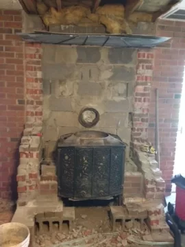

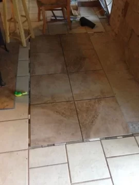

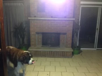

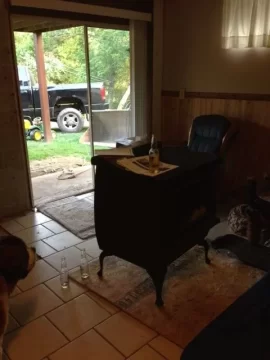

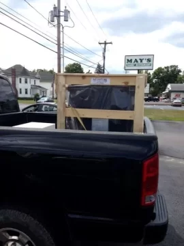

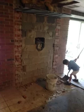

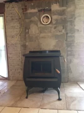

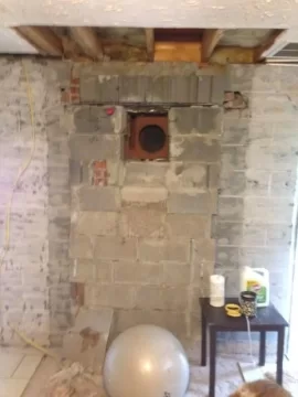

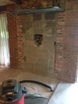

I would like to thank all of the members for all the great information they have provided. Here are some pics of the demo and new install...

Dogs name is Ruger he is 12 years old and is now a cellar dweller, since he does not like steps. He guards the stove, beer and guns.

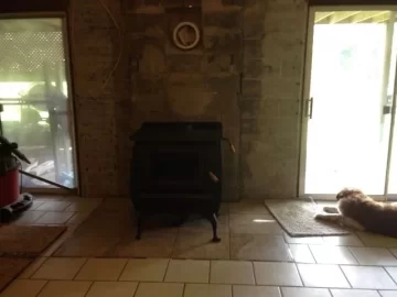

The king is in place.
Plan on putting veneer stone on the wall. Rock board on the ceiling. Any one have any ideas how to fininsh the ceiling, its open because of the fireplace insert removal. Was thinking rock board, two can lights and ???

Regarding the ceiling, how much clearance does the new stove require? If you have adequate clearance you could always just try to match the existing ceiling if that is possible. If clearance is an issue you could consider getting one of those ember protection hearth pads (the solid ones that simulate tile or rock) and then screw it to the rock board ceiling section while leaving a one inch air space behind it by using suitable spacers.

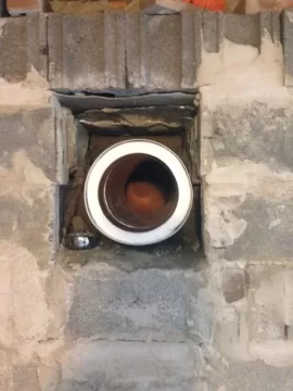

I'm curious your liner and thimble set up. I can see the pipe opening in your photos and am wondering if that is a T with a clean out or some sort of 90 degree angle section? How will you clean out the debris that falls into that area when you do a sweep? I have a similar set up on our stove in the lower level of our home. I have single wall pipe between the stove and the thimble and I pull that pipe off when I clean so I can scoop the debris out from the bottom of the T.
Ceiling is 8 ft. Prob just match the exsisting textured ceiling. Liner is a class A pipe in to the terracota 12X12 liner all cemented in. As far as clean out i could just use the regular clean out on the exterior.
