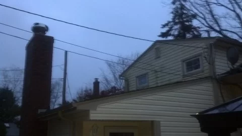

I have a 18ft Masonary Chimney on a exterior wall of my house w/ a 13x13 flu having a insert installed next week w/ a 6in flex SS liner.
The installer said he will insulate the top under cap and at the bottom where original damper was. He said it wouldn't be necessary to insulate the liner??
I'm on Long Island NY coldest normally is 20 degrees F to teens normally. I called a few installers and all seemed to say they normally don't insulate the liners??
I want this installed properly should i order 1/2 in insulation for the liner and have the installer use it??
Any particular bran better Found it at chimney liner direct.com for 227 for 25 ft

That is a lot of bricks exposed to the cold. I would insulate it. The size of the tiles should make it easy to slide an insulated liner down it.
+1 I live on Long Island also and have seen installs on exterior chimneys done both with and without insulation. The insulated ones draft better in general. On cold starts it is quicker and easier to get the draft going. Sweeping the flue, on average, gives less accumulated creosote.
In a 13 x 13 flue it should be an easy job to drop an insulated liner in.

Thanks guys going to order one! Have you seen installers use regualr R30 fiberglass insualtion to insulate the damper and top of chimney?? Every place seems to use it I have called and not Rock wool Roxul??
I use Roxul at the damper and usually at the top also. The damper area gets pretty hot and I personally do not trust fiberglass there. At the top the gasses are much cooler. I do not have a problem with fiberglass there but usually have Roxul left over from the damper area so I just use it on the top.
