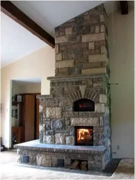

Don't make the mistake of so many modern homes by tacking them onto the end of the house in a great room. Make the fireplace central to the floorplan and keep the chimney inside the house envelope. If you are considering full time wood heat you might want to look at masonry or a Russian fireplaces for 24/7 heating. It can be used as a room divider and focal point. Run an extra flue in the masonry if you think you will want a wood stove in the basement.
[Hearth.com] Fireplace placement for new construction
http://woodheat.org/locating-chimney.html
(broken link removed to http://www.tulikivi.com/usa-can)
http://www.timwmasonry.com/Service/russian-fireplace-seattle.htm
(broken link removed)

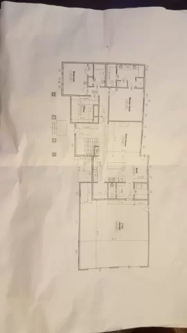

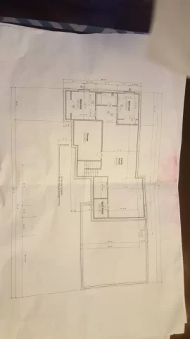

Thanks for the input. Yes I plan on putting an epa certified fireplace for the upstairs. It is pretty central in the layout and doesn't border an outside wall. I figures pellet downstairs cause I won't be down there as much and down want to be hauling logs down the stairs. Pellets seem easier, though I could be wrong. I also thought about putting a propane fireplace downstairs, though I don't know what I would be gaining as my furnace is propane and would be the same cost to run.
  • [Hearth.com] Fireplace placement for new construction
There are several good EPA fireplaces on the market. The central location will help even out the heat. How tall are the ceilings in great room?
