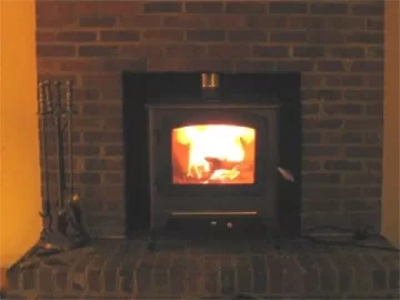

Just wanted to say thank you for your reply. This information was very helpful to me. Just installed yesterday.....finally warmed up in here! Thanks again.

Just wanted to say thanks for your reply....Appreciate your advice and response, it was helpful. I went with the flex liner with no insulation....going to burn it like this for a while, and see how it goes. I was told to use pink (regular) fiberglass insulation with no backing to insulate at the top and bottom of the stove, but learned that is not good advice.
Just curious what you use for insulation at the top and bottom of the pipe, or if you don't insulate at all.
Anyway, thanks again for your help.
Roxul mineral wool insulation is what I used. You can get it at Lowe's these days.

Thanks for the photos and for reaching out to me. Sorry I didn't get back to you sooner. I am still burning now, too! When will it warm up? Anyway, I am thoroughly enjoying the stove and this set up. Just trying to get as much heat out of it as possible.
