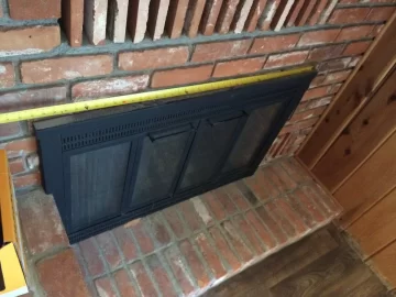

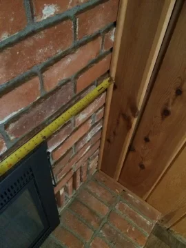

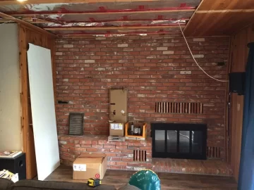

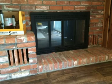

Hello folks,
I've been watching this forum for a year or so, and have finally gotten to the point where I need to do something to my house. I have a downstairs fireplace, with a opening about 36" wide by 24" high, by about 25" deep. It has a Heatilator so I'm sure I can remove that. I've been to the top of the chimney and it appears to be about 9-10" square, lined with some firebrick or whatever that stuff is called. I would like to do a Quadrafire insert (5100 series will fit) but have been thinking and would really like a stove as I think the radiant heat would be better. I also need to remove some of the brick to the left of the current fireplace to allow for clearance, and will place brick on the right side as the wall is about 12" from the fireplace, as well as extend the hearth. House was built in the 60s.
Would it be possible or beneficial to have a Quadrafire stove (4300 Millenium or 3100 Millenium, or 3100 limited edition which looks great) with a pipe going into the wall above the Heatilator vent system, punching into the chimney with a insert/liner? I'm not worried about cost to remodel this as I'm doing the rest of the room and want it done right. I just want to make sure that this will work well. If their inserts are as efficient heat-wise, then I'll stick with that as it means I only need to move some brick around vs. punching holes through the brick (which I'll later cover with stone to look better). The room in question is about 900 sq feet (downstairs playroom), with central heat intake that I'll enlarge on the left side room in the photos to help bring in and circulate the warm air to the rest of the house (about 3000 sq ft, tri level).
Any thoughts about stove vs. insert here? I realize Quadrafires are convection vs. old-school radiant heat, but I just want my wood to go the longest when it's burned and if a stove would be best, I'd welcome any thoughts as to what to do to get the stove pipe (several 90 degree angles needed) through the wall into the chimney efficiently.

You need to have a sweep out to look at what you have and give you options. And by the way it is no where near as simple as just moving some bricks. You may be able to go through above the firebox but it may also not be an option someone really needs to be there to investigate. As far as insert versus stove a stove will be a little better but if the insert is installed properly it wont be that big of a difference.
A freestanding stove will naturally convect and radiate more heat into the room due to the much greater surface exposure. That said an insert would look more trim and if you get one that projects a bit more out onto the hearth it will convect reasonably. You could put a screen of black painted expanded metal on the rear side opening to vent more heat from the insert.
