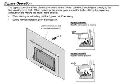

3) Can I just run it with the damper open, thus bypassing the catalyst? What are problems with keep the damp open? The only issue I see is that the cat element would not be used

Bypass mode defeats both secondary combustion processes. It bypasses not only the cat but also the secondary air tubes. You're wasting wood and heat. Fireplace X (Lopi) makes 3 flush non-cat inserts. I have one.

I suppose you could technically take out the Cat and run it with just the secondary tubes. I personally wouldn't do it. Not sure why you are so against using the Cat, it burns cleaner and longer while giving off more heat...

The guy at the stove shop simply doesn’t know what he’s talking about. The stove is designed around the catalyst, without it in place the airflow is significantly altered and can overfire the stove. Not a flue fire, but actual damage to the stove.. The chimney police aren’t going to Deans to arrest him, but I can assure you that Travis Industries won’t honor any warranties for them if the cat wasn’t being used.
