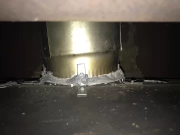

Attached a pic of the flue connection - you can see the compound used to seal it. There was a spot in the back out of sight that felt odd so I used a short length of 14 gauge wire to poke around and there is a gap around 3/16" wide and an inch long in the connection. I was able to stick the wire in and move it around quite a bit. Need to figure out what was used and seal it back up.
Not a huge hole - though I'm not experienced enough to know what kind of impact his could have. It looks like the liner may have settled leaning left, some of the compound was pushed into the opening on the left.

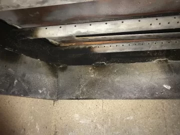

Baffle doesn't look like its blocking the cat, and its sitting evenly under the bypass opening too. I attached a pic of the baffle at the left rear part of the firebox where I think it should be resting on the rear air tube, that distance between is warp. Buzzsawboy, can you confirm?

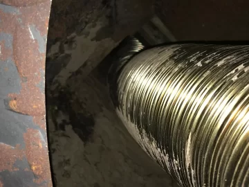

Also took a pic of liner just for fun.

Jeez, angle bracket and self tapping sheet metal screws into the stove and furnace cement everywhere... I don't know what is even going on there. @bholler ?
Edit: I just checked the manual and it calls for 3 angle brackets and furnace cement. _g My bad there, but it does look like you could use a straight connection and a new cement job.
I think I see enough airspace in there for at least some dilution air to be entering the flue (which is terrible for both draft and creosote). Could you post close ups of that joint all the way around?
The stovetop adaptor needed to be cut down so the hub sits tightly against the stove top. As it is, not only is there a big gap, but the adapter is barely inserted into flue collar. Lopi has a small ear that prevents the adaptor from interfering with the bypass rod. To do it properly, a notch is made to straddle this ear and some of the crimp gets cut off so the hub sits down nicely. Then furnace cement gets applied.
