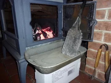

I sold my Fireview to my BIL, and don't shovel the Keystone, obviously. But I used a long, shallow pan which I held under the door with one hand so that any escaping ash dust would get sucked back into the stove. Then I scraped the big coals to the back of the box with the side of the shovel. Then got a shovel-full of ash, put the end of the shovel in the bottom of the pan, tilted the shovel up and carefully slid the ash off into the bottom of the pan while moving the shovel down the length of the pan. I got pretty good at it, and seldom had much ash dust at all escaping. I had the pan resting on a cardboard box here, so I could snap a pic.

Woody Stover, Good point having the pan the same height of the door helps control the ash dust as it tends to be sucked back into the stove.
Thanks for sharing your method.
