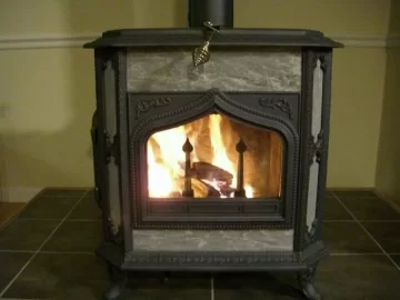

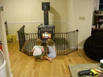

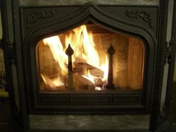

Well... I took the advice to go ahead and get that first kindling only fire done tonight. My wife voted against it, but the kids were all for it so she (for once) was overruled, heh. Not that this fire really put out any meaningful heat. A little bit of odor once it was flaming, but not too bad. You can see how little fuel I put in there - it is a pile of very dry punky chunks and a few sticks that I have had in the basement all year, not more than a large handful. Used a tiny piece of a SC to get it started (I hate using paper you know).
So - overall I'm pretty impressed with how easily it got going. I didn't have an impressive draft to begin with (it is 70*ish in and out and raining afterall) so shortly after lighting the firebox was filled with smoke, but it cleared after a few minutes and the pieces were flaming up brightly. As expected, the flue pipe warmed up quick and started to smell a bit (no visible smoke, guess I didn't get it hot enough for that - only up to about 260f via IR) and the stone peaked at about 160 near the top back of the stove. The door was the hottest part of the actual stove with the metal measuring 250+. The flame was over for the most part about 45 minutes after ignition as I didn't feed it. Now sitting almost 2 hrs post ignition and the stove top is about same temp across it and measuring 115f range, sides a bit warmer than that, no coals visible. I'm impressed that it appears everything I fed it burned up - I had expected only the center of the pile to burn and leave the edges (ala the stereotype campfire in the woods with burnt ends laying around ashes and partial coals).
So here are the pictures - If I can manage to get the house cooled down tonight and the kids complaining about being cold in the morning maybe I'll get another go at it tomorrow, heh.

Looks nice. I like the two little fire bugs watching the fire. I'm currently doing the same thing just to get the summer moisture out. The weather tomorrow may call for a small fire as well.
"fire bugs" - indeed they are. This morning the first thing they did was ask me to get another fire going. Oh it is nice to have them on my side, heh. They are disappointed that I won't get a big fire going to "warm their feet." Once the fire started to die down my youngest really started to complain too. Just to make them happy (yeah right) I did do my second fire this morning.
