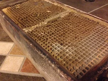

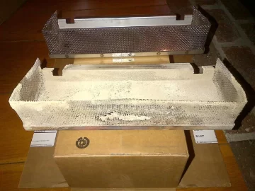

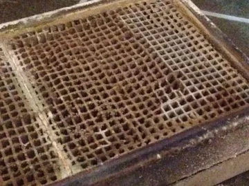

Cat scoop was really beginning to sag last winter, to the point it was taking up valuable firebox space. In the process of installing the new stainless scoop, I discovered the ceramic cat was beginning to fall apart. So, another call to Woodstock and a new steel cat was (is) on the way.
For those that have installed the new Fireview scoop, how is it holding up? It is made out of thinner material than I was expecting. Maybe the stainless can hold up to the heat better?

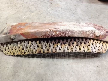

I replaced that scoop a few years ago due to warping. You're better off than me though. Last Winter I bout a new metal CAT, and this spring I bought the new stainless scoop and bypass frame. While putting in the bypass frame I cracked the combustor pan...which is the whole guts of the stove. Luckily I live in NH so I have a guy coming from Woodstock to replace the pan, all my gaskets, etc. It'll basically be rebuilt except for the door and stone HAHA. It's worth it...it's 13 years old and has saved me thousands of dollars in heating bills, and provided countless warm nights when the power is out. Great stoves but things do start to warp and need replacement.

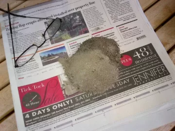

This will be my fourth year burning in my Fireview - awesome little stove - kind of wet my appetite to something larger next time but I am so a CAT guy now - 5 cords last year and look at that ash - this thing burns so clean.
Anyhow - I am a little disappointed with the screen - the mesh just burned up after three seasons - I purchased a new one last week and although I realize the CAT would have to be replaced after some time (5+ years) but did not think the scoop was a consumable as well...

I think just about all the parts in a stove will need t be replaced eventually. My stove is 13 years old, I'm on my 3rd cat, 3rd scoop/ and now the whole combustor pan is being replaced this week...along with gaskets, bypass frame, etc...I'll probably swap out the andirons and the bracket they attach to also...they're starting to bend toward the glass just a bit. I dont over fire my stove, but it runs constantly all winter and that takes it's toll. Luckily, the parts are fairly cheap so not a huge deal to replace as needed.
I wonder if they'll redesign the mesh screen on the updated stainless scoop. It doesn't seem like it would last that long being so close to the Cat. At least the part is easy to swap out with the two removable pins...but the mesh is riveted to the scoop so you have to swap the entire part. May not be a bad thing, I bet by the time the screen burns the scoop must be starting to warp, I would think.
