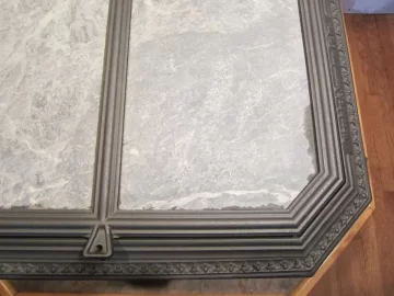

Hello all, I bought a Woodstock FireView last fall and i just noticed some staining on the top of the soap stone. It looks like the gasket cement is leaching outward onto the stone. Has anyone experienced this with their soap stone stove and if so how did you clean it?

Thanks for the replies, I am sending them an email today along with the pictures and I will follow up with a phone call tomorrow and see if I can figure this out. The only place it is staining is on the top. Even stranger than that is I haven't used the stove in 3 months and this just appeared in the last week or so.
Just out of curiosity, have you lifted the top and looked underneath? Is there a stain on the bottom of the stone? If that stain has definitely appeared in the past week, it's odd. What has happened in that time? Lots of rain? It isn't a moisture stain, is it? Has it changed day to day? Did you have anything on top of the stove? Could anyone in the family have put something on the stove? Just thinking....that statement that it has appeared suddenly long after and unrelated to burning has me wondering....Hopefully Woodstock has some answers tomorrow. Would be interested in hearing what they say.
No stain on the bottom of the stone, the stain could have appeared in the last month or so, not exactly sure when. I'm almost positive it did not happen during the burn season though. Nothing out of the ordinary has happened and no spills, everyone in the house knows this stove is my baby....... :) It's definitely coming from under the cast iron on the top of the stove. I did burn some wet wood at the end of the season so maybe that contributed to the staining, I don't know. I just want to make sure it's safe and get it fixed before the winter.

D_Skee, we have seen this before in the off season, especially in humid weather. Moisture in the air can wick into the gasket and onto the stone. In most cases the stain will go away in drier weather. You can buff it with some very fine steel wool (000 or 0000) if you like. Most people do not realize that soapstone is a very dense stone and virtually nothing will penetrate its surface. This is why laboratory table tops are made from it, very non-reactive. Give a call if you have any other questions. Hope this helps.

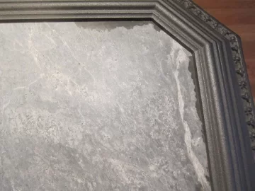

After about a week of not looking at the stove, I just saw that I have the same thing happening!
(broken image removed)
Like dylskee, I haven't burned in several weeks, so here's my theory; On a warm, sunny day the attic air gets hot and starts a chimney effect in the house, drawing warm, moist air down the chimney pipe and into the stove. The moist air is then pulled out into the house past the stone gasket. Moisture condenses on the cooler cast iron frame of the lid near the gasket and dissolves a little creosote. This " creo-water" then wicks through the stone gasket and onto the surface of the stone. I think it's just on the surface of the stone, or very shallow, and will be able to be buffed out with 0000 steel wool. I'll wait to see what dylskee hears before proceeding, though....

The staining that you are seeing around the perimeter of your stove is typically caused by moisture/humidity pulling down through your chimney when not in use, and then wicking through the fiberglass gasket which forms a seal to the stone.
One way of mitigating this problem would be through blocking your stove pipe with some insulation in the offseason to prevent the downward flow of air. The key here is to stick a note on the pipe so you don't forget to remove the insulation when you start up your stove at the beginning of the heating season.
To remove the moisture discoloration, I would first start simply by buffing the areas with fine aught steel wool. If that is not effective, and you've stopped the source of the moisture, you can remove the stone from the top casting and use an orbital sander with a very fine grit (220) on the stone.

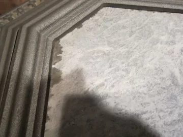

I forgot to describe this pic that I had posted above. This is the underside of the front of the lid. The large gasket is the lid frame gasket. Then the part of the frame inside the top of the stove, that's got some creo on it. I'm assuming this is where the moisture condenses. Then, barely visible, is a thin, light-colored line which is the edge of the stone gasket, between the top of the stone and the frame. You can see the 90* corner of the stone, and on the top edge of the front of the stone, some creo has been deposited (kinda hard to see, almost looks like a shadow.)
