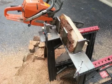

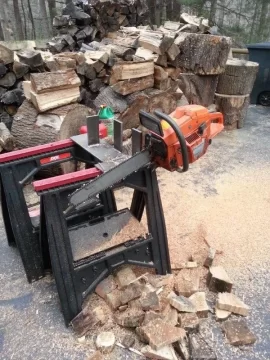

A couple of weeks ago I installed a BK Princess insert into our fireplace (which has far exceeded our expectations). That created a small problem.........the insert, ideally, needs 16" long splits. The length I've been cutting to over the years has been 18-22". After having culled through my stack to get the few short pieces that would fit I needed to figure out a rapid way to get them shorter before the cold snap came through recently.
Here's what I whipped up real quick. Seems to work pretty well.
[Hearth.com] Firewood Chop Saw [Hearth.com] Firewood Chop Saw
Nice, I approve! Good looking beads there. I also like the pivot design. I always appreciate simple, well-made solutions. How's the balance?
Thanks for the kind words......Once I moved the pivot back to the rear bar screw stud it was balanced very nice. The saw is sitting balanced in the picture.

Does it put much pressure on the stud? Wouldn't want to break it off.
That was a concern at first, but I found that the saw has enough power (394xp) that I really put very little pressure on the split when going through it since the cross-sections are so small. I was prepared to make a little bracket that attached to both studs if it seemed to be a problem but I think it will be okay.
I used 3/4" hex bar (4140PH) to mount to the stud, so there's a good bit of surface area surrounding and supporting it to help keep it from snapping off.
I really don't want to have to EDM a broken stud out of the bar mount. lol
I like to place a nut over a broken bolt/stud, then wire weld thru the hole to attach the nut, let cool and back it out. The heating and cooling will frequently free a frozen stud. Much faster, and if it fails you can always EDM.

Neat and simple build. I like it. I once saw a different (more difficult) design where a guard was made for the nose sprocket and a grip handle attached with a squeeze throttle in the handle. Work just like a chop saw. That was pretty cool too, but I like the simplistic style of your build.

did u weld that holder just for this? or did you already have it?
i have used an actual electric chop saw with great results.
i have too, but something inside me was very apprehensive about it. The piece not being even on either sides is not predictable. I only do it for scrap lumber now.
Everything about the fixture was just for this. The material was convenient and wasn't being used for a particular job. I just sawed it to the lengths I needed, deburred, and welded. No precision, just quick to try and beat the arctic air that was coming.
i'm wondering why a wood holder (2x6) wouldn't have been preferable, it case the saw hit it for some reason.
I'm sure the 2X6 would have made a good holder, I just didn't have one around. I whipped the base and uprights together quicker than I could have gone to the store and purchased the wood.
I'm sure I could have figured a way to make the saw mount very rigid to the wood base though.
The nice thing about using wood is that it would have been easy to adjust if I was off a bit. Welds.....not so much. lol
