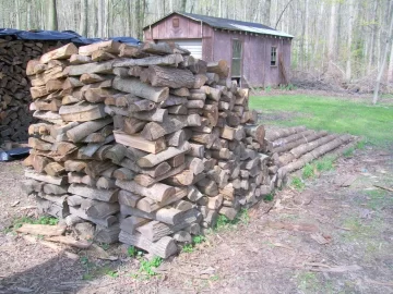

Is your property wooded? Reason I ask, if it is, you can cut saplings to stack your firewood on. Photo below.
That's how we do. The saplings last for several years and they're easy enough to replace once they're too rotten to use anymore. Ya don't need concrete slabs, cinderblocks, store-bought timbers, pallets, any of that.
You can stack two rows with a foot or so of space between them, it'll season just fine. For single rows, just cut top cover material to fit and lay splits or ugly pieces on it to hold it fast.
Making stacks longer helps, too. I used to make ours 20' in length. They're closer to 30' now.
If you're gonna need wood for next winter I'd respectfully suggest that you get it split and stacked right away. Soft maple, if you can get it, seasons well enough to burn in less than a year.
