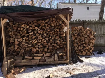

Just wanted to show you a pic of what I got last night . So happy I can start burning again.
Well done. Very hard to find firewood of that quality and moisture content this time of year from a dealer.
