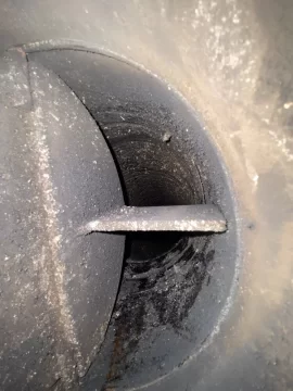

I usually get a sweep every other year. Does this look pretty dirty?

I suggest to sweep (or have swept) your flue once a year. If you do this at the end of the season, you can start burning anytime in the fall. And you don't have the dirt in there during the humid summer. Your insurance will also like it if you can show a sweep receipt if something happens.

That's the bottom of the flue, where the gasses are hottest and the flue is cleanest. The top will be dirtier.
You've only had a fire or 2, you should still be OK.

Not sure if you can, but looking at your chimney from the top down would give you the best idea of how much buildup is in there. The reason is that there is usually more buildup up top. Looking for the bottom up will show you the least amount usually.
