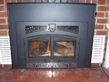

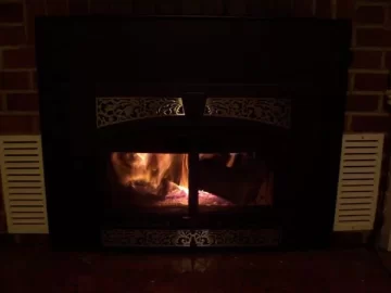

Here are some pics. One with the flash, one without.
  • [Hearth.com] First burn!

Great looking stove!
What is your hearth made of? I like it - looks interesting and different.
x1 that is an unsual hearth. grats on the insert as well
Thanks, guys. I don't know exactly what the hearth is made from. As far as I can tell, it's just what it looks like: some kind of red rock chips. The rock appears to naturally be that color, i.e., not dyed or painted.
LOL I actually don't like it. I think it's ugly. I prefer clean, crisp lines, rather than what looks like a broken driveway to me. However, I do like that it is reddish to match the brick. I would have preferred a brick hearth or something. But hey, I wasn't around when it was built 60 years ago, so I didn't get a say in the matter. haha
