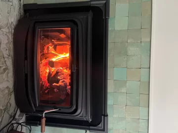

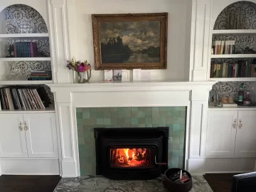

I really appreciate this forum's advice. Followed the BK instructions to the letter, was sure to use dry wood, and got this thing up and running on the first try. Cat is active. Definitely a fairly strong smell and some curing smoke for the last 30 minutes or so. [Hearth.com] Blaze King Break-In Fumes -- How Long/Bad?

Very nice. If memory serves, the smell of new stove burning is fairly strong but temporary. Sort of like self-cleaning an oven.
