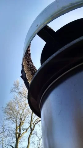

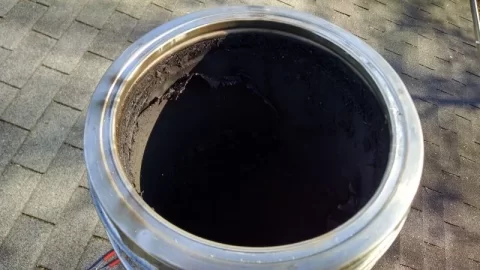

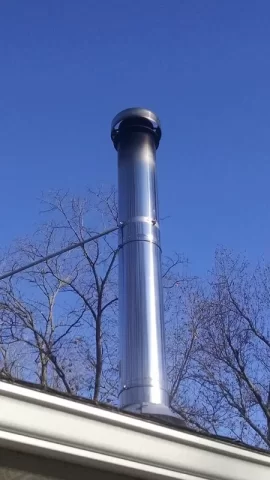

Just got around to inspecting and cleaning the flue since installing the stove last winter. It wasn't used much last year and this year we modified the stove and have been burning some marginal at best wood... Figured it would be best to check things over before the cold sets in...
I had noticed some discoloration of the stack and some buildup on the cap...

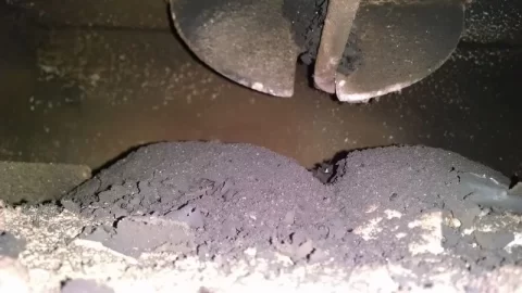

This is how the pipe looked... Almost like it was lined with charred paper..

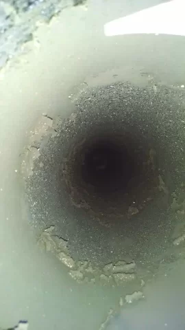

After brushing...

Although it looks like more in the pic... It's a cup full or so of a very flakey material. No sticky/gummy material at all.
Does this look on par for say 3 months of off and on burning last winter (very off and on)... And a few weeks this year with a couple 3-4day round the clock burns...
Should I be good for the season or should I plan for a mid season cleaning?

I would at least check it mid-season. Which is gonna have a whole new definition this year. I usually consider mid-season to be early January but am moving that to early February this year.

I think you are fine for now. The top of my stack looks very similar to yours.
