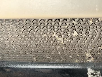

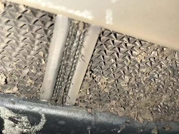

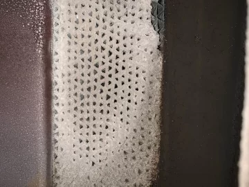

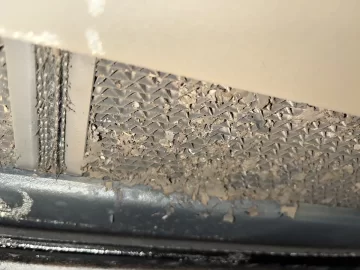

Also the complete lack of an ash bed to insulate the coals.You may get water on the first load or two every year...the firebrick seems to absorb moisture over the summer...the first load or two don't always burn the best either...

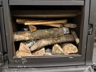

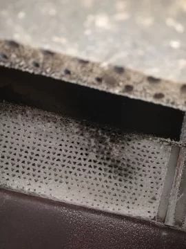

I’m currently losing temp and the thing is slowly dying down. Flu probe is down to 225. Stove top is down to 300. I have not used the catalyst (because that really puts it out), I have a window nearby cracked to let air in the house. Not sure what I’m missing. At this point in the fire load, moisture shouldn’t be an issue? These two photos are taken at the same point, but ones with a flash and one isn’t, so they look quite different.
View attachment 282519 View attachment 282520
It's a rule of thumb but not a law of physics. It wouldn't surprise me if it was off from that by 100 degrees or more depending on the situation.
That's why people have flue probes instead of just shooting the external temp of their double wall. Don't ditch the flue probe unless another flue probe is giving you wildly different readings.

I’m still debating buying and trying another flue probe - can anyone weigh in on whether this seems like accurate/correct numbers?-still thinking my flue probe is not accurate. I had the Cat cruising right in the middle of its zone. the STT per infrared laser peaked at 675 and then settled in around 550. but my flue gases were supposedly never above 450, and most of the time that gauge hovers right at 400 or even lower. Does this seem right/possible? (flue probe through the double wall exactly 20" above the stove)
