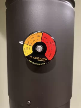

So 45 mins in, I have air full open, stove top at 400, I am getting some secondaries firing, but probe gauge is still showing 300 on the flu gases and won’t go higher. That sound normal?

IR gun on the outside of the double wall is giving me 175 about 16 inches up.

I think you may be right. It’s actually settled in and running slow but OK now. But losing flu temp, I’m wondering if my probe gauge is broken.

Even now tho, the IR gun is giving me 125 on the outside of double wall, isn’t the rule of thumb double the external temp for the internal temp on single wall?
So a flu probe reading 225 right now must be busted…

Surface temps on double-wall stove pipe don't mean very much. There is no rule of thumb. The probe thermometer is a better indicator. With a small dying fire a reading of 225 is not unusual.
It's a rule of thumb but not a law of physics. It wouldn't surprise me if it was off from that by 100 degrees or more depending on the situation.
That's why people have flue probes instead of just shooting the external temp of their double wall. Don't ditch the flue probe unless another flue probe is giving you wildly different readings.
