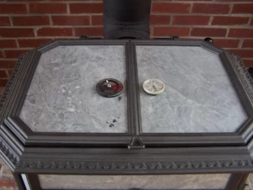

It usually takes us a good 12 hour HOT burn cycle to fully reheat our 150 year old poorly insulated home.
A short burn cycle with the PH would be about 6 hours really, load her up 1/2 to 2/3 and slowly work down to under 25% open on the air and you'll quickly cruise up to 600 degrees on the stove top and stay over 500 for about 3 hours.
I like to do this to get a lot of heat out of the front of the stove, it really blasts some serious heat that way.
I'm still very confused about where to put the thermometer, people talk about having it on the right corner of the collar but when I've spoken to them they still say put it on the stone above the catalyst. Maybe it's because I don't have the cooktop on it.
I'm going to call them again tomorrow just to be sure...

WOW! Cross cut your getting the Soapstone top up to 600 degrees? I have the cooktop, I guess the new one with the stainless heat shield under it (there is a thin SS metal shield with an air cushion attached to the bottom of the cast cooktop). I have never got my soapstone above 300. It's ussually about 250, but the soapstone sides will be 450 to 470.
Man, if I loaded 2/3's full and left air at or above 25%, I would heat my house to 100, and my neighbors houses and prolly neighborhood to 100 too!
Yeah, there is really nothing between the soapstone and the stove but a thin piece of metal, and even that has a circular hole in it right about in the position of where that thermometer is.
How insulated is your house? Mine is 150 years old with NO insulation in the walls and a front door that might as well be cracked open. I'm working on these things but for the time being it is what it is.
The stove is in what used to be the formal dining room that is now the "parlor", it stays in the lower to mid 80's when the stove is humming and the rest of the house will be about 70 degrees.
250 is where they suggest firing off the cat, mine hasn't dipped below 250 in quite some time...

I took an IR gun to my Fireview while it was up and cruising and just shot the stove top to find the hot spot. That was about centered on the stove top.

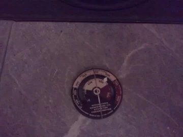

Hmm... will have to be careful then I suppose. However, I imaging that you had a LOT of heat out of the front of that stove there HollowHill!
I wouldn't leave it burning on higher heat unless watching it closely, but so far I haven't burned it much over 350-400 surface temp, I would like to see it get up to 500+ and see what it is like.
Well, looks like I may have overreacted (soooo unusual :rolleyes: ), as I looked at the andiron last nite when the stove was at 425 and that same andiron was again lighter than the other. Upon closer examination, I think I'm just seeing the glowing embers reflecting in the glass and back onto the andiron, making it appear lighter in color and sort of reddish. So, maybe you don't have to worry, Slow1. Just keep an eye on it at first, it certainly was controllable the entire time even at 570. And, just maybe, if your not the Nervous Nellie that I am, everything will be fine ;em
And it was throwing out a tremendous amount of heat! Wow!!!
You should feel that bad boy when it's cranking at 600, you can't get your hand within 6 inches of the glass.
