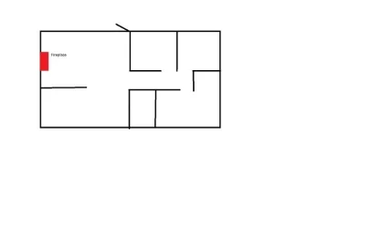

My neighbor raves about his wood stove and spends his summer cutting up wood. He told me it's more of an obsession than a hobby now. After rising oil costs, and the offer for free wood (have to cut and split myself), I pondered the idea of getting an insert for my otherwise useless fireplace. I have a 1200 sq ft 1 story ranch and the fireplace is all the way at one end of the house (CRUDE drawing attached if I can figure it out). I have replacement windows and insulated attic.
Again, a job well done . . . some of the best advice I got here when I was contemplating getting a woodstove was to first spend your money on insulating a home so that when you get a woodstove you can retain the heat you generate rather than attempting to help PETA save the squirrels from freezing to death.

Are the bedrooms going to get much heat? (Insert will have a blower)
I think the size of your house would mean that the heat would get to the bedrooms . . . but it would be a bit cooler . . . which most folks prefer anyways.
