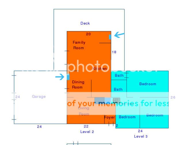

    Alright, I had been debating getting a ductless system for about two years now (lived in this house for over three) due to the heating issues I've had in the past. We live in a 2100 sq.ft split level that had baseboard and a woodstove in the closed off basement when we bought it. The first winter we owned the home, heating was futile. The woodstove in the basement couldn't due much since there was no direct access to the living area above, not to mention the fiberglass batting in the basement ceiling.
    The next winter, we removed the batting, and built a set of stairs into the basement from the kitchen above (picture taking a circular saw to your hardwood flooring). I also purchased an Englander NC-30 stove to replace the smoke dragon that we had. That made a HUGE difference, but we still needed to supplement upstairs with an Edenpure, that to me, wasn't very efficient and still couldn't keep the temps higher than about 66 on average.
    Our lowest living level was remodeled the year we bought it, and we built a stone fireplace with a Regency P90 propane fireplace. That heats the ~500sq.ft family room more than adequelty. It was out main floor (the kitchen/gym/living room) that was struggling to stay warm. So after much research, we went with a local Mitsubishi Diamond installer, and purchased a Mitsubishi MXZ-2B20NA with MSZ-GE09NA and MSZ-GE12NA evaporators. These were to service our ~900 sq. ft main floor.
    They were placed in the following locations:

    Here is why your problem is occurring. Your indoor unit is located on an outside wall.The indoor unit is talking in air from near that wall, and that air is colder than what is in the middle of the room, or on another interior wall. The units temp sensor senses the air temp as it enters the unit. So the unit thinks the room itself is colder that what it is. There is no way around the issue, just know what you need to set it to be comfortable, and take comfort in knowing that your heatpump is in fact working as designed. Hope this helps.

    Thanks for the insight on a few things. I'll try to address them as best as I can.
    First, the operating range. I'm aware that's not assuming full rated Btu/hr output at those temps. The point was that at an outdoor temps of ~25 degrees, this unit should not be struggling to maintain temps inside at 70 degrees.
    I don't have the manual in front of me here at work, but I found specs from the Mitsubishi which oddly are different than mine in terms of operating temps (states 6 degrees F at the lower limit). At 47 degrees, it has a max rated output of 22,000 Btu/hr and 12,500 btu/hr at 17 degrees.
    I am slightly concerned now that it is undersized. I didn't actually do a formal load calculation, but I had the installer come out and we talked about the room layout, insulation level, and the fact that there are two walls of windows in this room as well. In the end, this was the unit he speced out for the situation. The compressor is sitting on a platform under my deck (has about 3 ft of vertical clearance), and one evaporator is mounted on a wall shared with the garage, and the other evaporator is on an exterior wall.
    I'm a bit confused about having to lower the temp levels to maintain a higher temp, unless, as was stated above, the place where the unit is drawing air in from is cooler/warmer.

    Sounds like you are undersized as you are trying to heat more than 900sqft, remember heat is rising up those stairs. As with all ASHP's as the outdoor temp drops so does your units ability to provide that heat just when you need it most. This is why a load calc is so important to determine your heating requirements, oversized a little no big deal, undersized a little and it becomes a big deal. Have you talked to the dealer yet? If they speced it and it doesn't keep up maybe they will work with you on a solution.

    Certainly some heat is convecting up to the third level 624 sq ft.. Not sure how much. You might try closing that area off for a few hours to see the difference. Given that there is only 2 tons of heat pump capacity, I would still plan on cranking up the 30NC when it got cold. In comparison, we have a 3 ton unit heating our 2000 sq ft house in a milder winter climate. Although it's a good model, it's less efficient than the mini-splits. The resistance heat kicks in at 24F outside if I don't have a fire going. That only happens when we are away.

    I agree with the above. The unit is prob sized to heat ~900 sq ft to a reasonable balance point (like the low 20s), and is struggling due to heat running to the upstairs. Either the upstairs will need to be cut off, or some supplementary heating (like the woodstove or baseboard) will be required.
    The unit is clearly undersized relative the OP's expectation, and I would blame the installer for that.

    Thanks for the input everyone. I had believed that the unit was trying to push heat upstairs since the temps in the hallway upstairs in the back bedroom were much more comfortable than in winter's past (especially these few mornings lately when we're in the mid 20s). I suppose at this point, I have two options. Live with it. Or try to get a bigger unit in place, which I doubt the dealer will be willing to do (and would it truly be worth it)?
