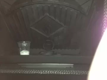

pics as promised
[Hearth.com] First Mt Vernon Cleaning
outside after I was finished (cleaned glass) and put back together
here's a shot after the paint was dry and I put a cup of damp-rid in the stove.
